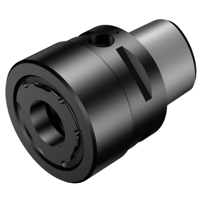

Adaptor with Coromant Capto® coupling to ER collet chuck
New
Available within a week
ISO: C4-W-391.14-25035-A
Material Id: 8489560
EAN: 7323227764986
ANSI: C4-W-391.14-25035-A
Coromant Capto (segment clamping only) -size C4
Connection - workpiece side
(ADINTWS)
ER collet (DIN6499-B) -ER25
Coolant exit style
axial concentric exit
Data chip pocket
(DCP)
Yes
Data chip pocket size
(DCPS)
Dia.=10 mm/Height=4,5 mm

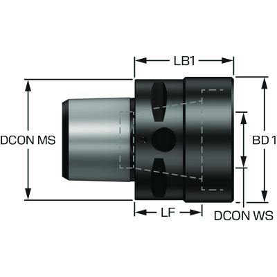

40 mm
Functional diameter
(DFC)
28 mm
Standard number
(STDNO)
ISO26623-1
Connection diameter workpiece side
(DCONWS)
26 mm
Kappa (z-axis rot)
(KAP)
23 mm
Body diameter
(BD_1)
43 mm
Body length
(LB_1)
35 mm
Body half taper angle
(BHTA_1)
Body material
Steel
Balancing method code
(BLMC)
No balancing
0.35 kg
59 mm
