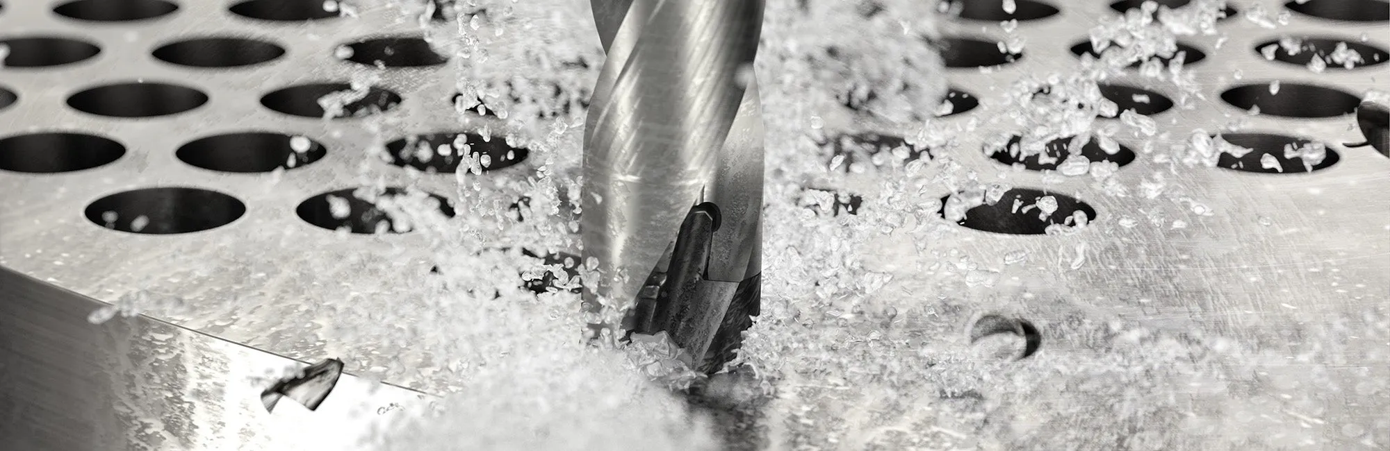

CoroDrill® DE10
Time for change
The overlooked potential of exchangeable-tip drills is substantial. It’s time for change.
Master high-volume hole making with CoroDrill® DE10.​
Redefining plug-and-play​
CoroDrill® DE10 is the new best-performing exchangeable-tip drill mastering productive short-hole drilling in all materials.​
With its universal -M5 geometry, CoroDrill® DE10 offers seamless plug-and-play functionality and uncompromised performance across a wide range of cutting data.
  • Productivity
  • Tool life
  • Robust design
  • Plug-and-play
  • Assortment
Productivity
Thriving in high feeds
The peak performance of CoroDrill® DE10 is achieved at high feeds and speeds, leveraging its unique geometry, high-performance grades and robust design.​
Increase your feed by 40% and watch your productivity soar and cost efficiency peak. Plus, you will reduce your CO2 emissions per operation by approximately 20%.*​
*Recorded in reference testing.​
Tool life
Get more from every drill
When paired with recommended feeds and speeds, CoroDrill® DE10 delivers unmatched tool life with an average increase of 40% or more, regardless of the material.​
Expect high, consistent quality from beginning to end and reduced cost per hole.​
Robust design
Familiar design with newfound security​
The pre-tension clamping interface of CoroDrill® DE10 is just like the ones you are used to but with next-level security. This patented solution is the most robust design of its kind, ensuring:​
  • Fast and easy tip changes, no spare parts needed​
  • Trouble-free drilling at high feeds and speeds​
  • Strength and high clamping forces ​
  • Good centering capabilities leading to straighter holes and tighter tolerances​
  • More drill tips per drill body​
Plug-and-play
One geometry. No compromise.
Tip geometry -M5 is one of a kind, offering uncompromised performance in all materials and a wide range of cutting data. In any other exchangeable-tip drill concept, you will need multiple geometries.​
With this one-fits-all design, CoroDrill® DE10 is easy to apply and exceptionally useful for mixed productions.​
Assortment
CoroDrill® DE10 is designed for short-hole drilling between diameters 9.00–17.90 mm (0.354–0.705 inch) and drill depths 3-8 x DC across all material groups, offering a large cutting data window with high cutting parameters right from the start. The concept includes cylindrical and cylindrical with flat shank types and presents the unique benefit of a single, versatile geometry that covers all materials.
