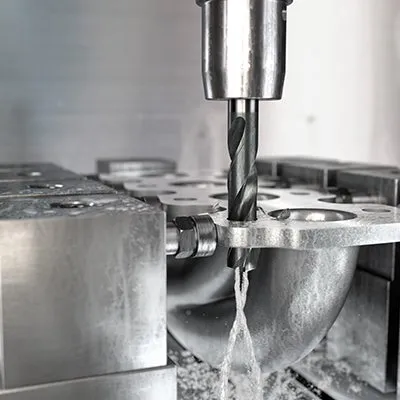

All-round hole making
With CoroDrill® Dura 462 you can expect predictable and trouble-free drilling across all materials. One drill for all materials achieves greater cost-efficiency and machine flexibility. Explore our extensive stocked standard assortment where you can find a drill for every need.

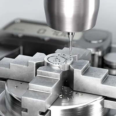

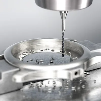

Micro drills with precision
The CoroDrill® Dura 462 micro range offers smaller drilling diameters starting from 0.03 mm (0.0012 inch), making it ideal for precision-work in small parts. Both uncoated and coated drills are available, providing precise performance where accuracy is key.

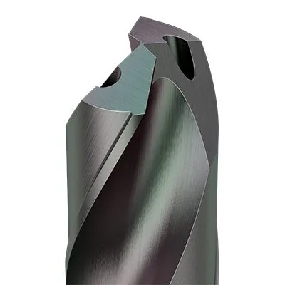

Made for durable drilling
A micro-grained cemented carbide substrate delivers an excellent combination of hardness and toughness. Paired with a PVD coating with the latest Zertivo® 2.0 technology, the result is high wear resistance and longer tool life. In addition, the drills have a tailored post-treatment for enhanced surface smoothness.
View more features
  • A strong parallel web design, combined with large flute volume, enhances chip evacuation.
  • Features a geometry designed to gain excellent machining stability and process security
  • Maximum productivity thanks to grade X2BM
  • Fully-coated drills to ensure high wear resistance
  • A robust design ensures good centering and hole straightness securing best possible pre-hole conditions for subsequent operations like tapping or reaming

  • Diameter range 3.00–20.00 mm (0.118–0.787 inch)
  • Drill depth up to 8×DC
  • Main industry segments: General engineering, automotive, aerospace, oil and gas and pump and valve
  • Typical components: Flanges, castings, sieves, hubs, valve bodies, pump bodies

Application, micro drills
  • Diameter range 0.030–3.00 mm (0.001–0.118 inch)
  • Drill depth up to 6×DC
  • Coated and uncoated tools available
  • Main industry segments: Medical, electronics, general engineering, watch-making, automotive, oil and gas, aerospace
  • Typical components: Hydraulic valve, watch case, medical devices and surgical instruments, electrical connectors, electronics, mould-making, actuators, sensors, navigational systems
