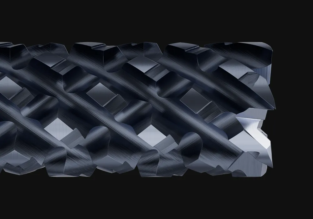

The serrated router, CoroMill® Plura composite 2P350, was developed to address these challenges directly, offering sharper, more durable edges and a geometry optimized for stable, low-defect machining. This is a significant step forward in stability, quality and process security when working in demanding composite applications.
Patented dual cutting mechanism
A crucial feature of CoroMill® Plura Composite 2P350 is its patented serrated geometry, designed to deliver a balanced, scissor-like dual cutting action. This coordinated mechanism effectively clamps and shears the fibres, reducing cutting forces and counters the tendency of composite layers to split and delaminate or produce uncut fibres.
The geometry balances cutting loads across all flutes, preventing any single tooth from taking excessive force. This results in lower and more consistent cutting forces compared to traditional routers, protecting both the tool and the workpiece. Reduced cutting forces also contribute to better surface finish and less risk of delamination or uncut fibres.
By disrupting harmonic vibrations, the geometry also contributes to a more stable and quieter machining process. The controlled cutting action not only improves surface integrity but also enables reliable one-pass machining, supporting both process security and a more comfortable sound level in the workshop.
