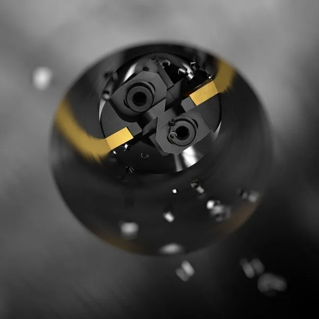

Rough boring is primarily focused on metal removal and to prepare the hole for finishing. Roughing machining is performed to open up an existing hole made by methods such as pre-machining, casting, forging. Rough boring tools can be configured for productive-, step- and single-edge boring.
Productive boring
Productive boring is the basic set-up for most boring applications and is the best choice for highest productivity.
It involves two or three cutting edges and is employed for roughing operations of holes, with tolerance IT9 or larger, where metal removal rate is the first priority. Feed rate is obtained by multiplying the feed for each insert by the number of inserts (fn = fz × z).
Step-boring
A step-boring tool has the inserts set at different axial heights and diameters. This method is used when a large radial depth of cut is required or to get improved chip control in long-chipping materials since the chips can be divided into smaller and easily handled chips. The number of tools and tool changes might be reduced when step boring.
The feed rate and produced surface finish is the same as if only one insert is used (fn=fz). Produced hole tolerance is IT9 or larger.
Single-edge boring
Single-edge boring is performed when using only one cutting edge. It can be beneficial in materials where chip control is demanding (e.g long-chipping materials), or when machine tool power is limited (fn = fz).
