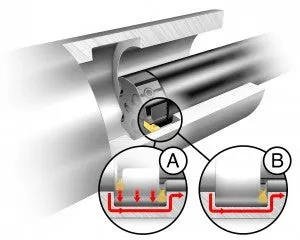

Long overhangs and poor chip evacuation are two of the challenges with internal grooving. Long overhangs can cause problems with both deflection and vibrations. Vibrations and poor chip evacuation can cause insert breakages. Difficulties with chip evacuation can also lead to poor surface finish. The most common internal grooving process is radial grooving, however multiple grooving (A) and plunge turning (B) can also be used.

- Vibration can be avoided by using several cuts with a narrower insert. End with a finishing operation (see illustration (A) right)
- An internal groove can also be machined with a single cut followed by plunge turning (B). Start at the bottom and machine from the back of the hole to the front to obtain best chip evacuation

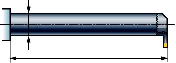

For overhang 5−7xD, use carbide reinforced dampened bars
L = 5−7xD

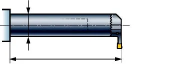

For overhang 3−6xD, use dampened or carbide bars
L = 3−6xD

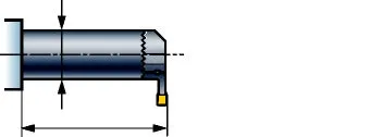

For overhang below 3xD, use steel bars
L ≤ 3xD

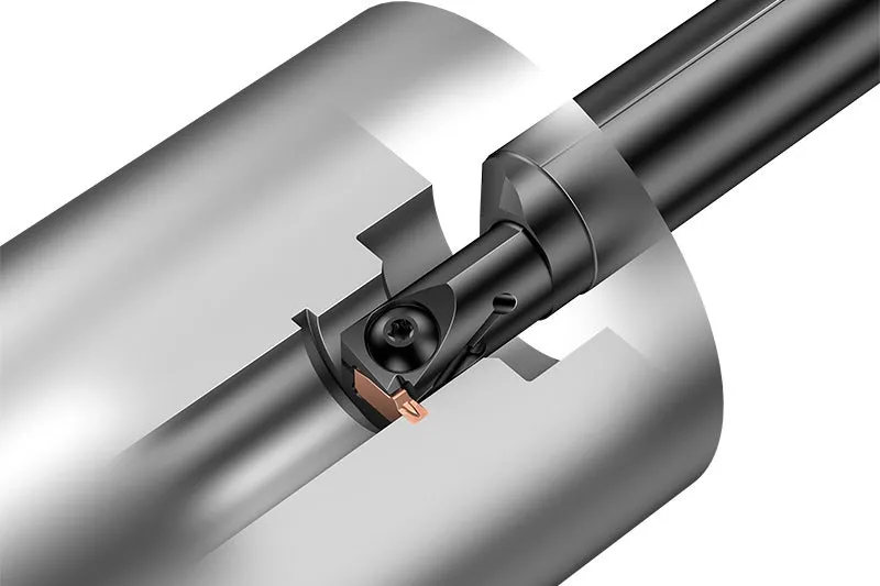

Roughing with radial feed
Always start closest to the bottom of the hole (1) and work outwards to make room for the chips. Use the recommended feed. Further cuts (2 and 3) should be 0.5–0.8 × insert width. Since the cutting force will be less at this point, you can increase the feed by 30‒50%.
