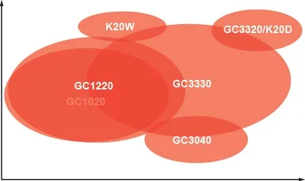

Find your grade
Our wide range of cast iron insert grades include CVD-, PVD-coated and uncoated carbide grades, and CBN-tipped and ceramic insert grades for various machining conditions. Use the information below to find the right grade for your production.
Stable conditions
Unstable conditions
Low heat
(Small cutters
and/or low vc, ae)
High heat
(Large cutters
and/or high vc, ae)
