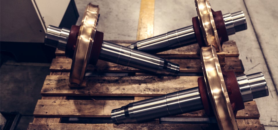

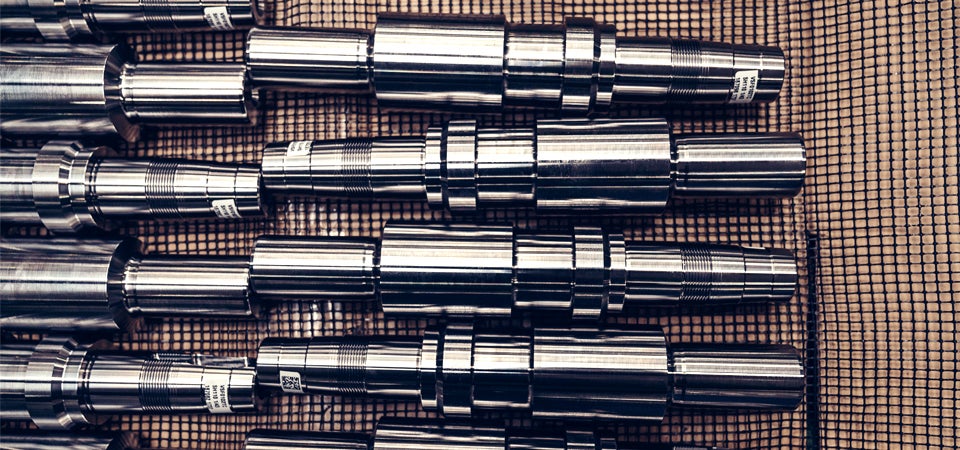

Worm shafts for worm gear winches are made from a drawn, reclaimed 42CrMo4 steel bar, hardness 290-310 Hb. The machining process requires 15 profile changes.
