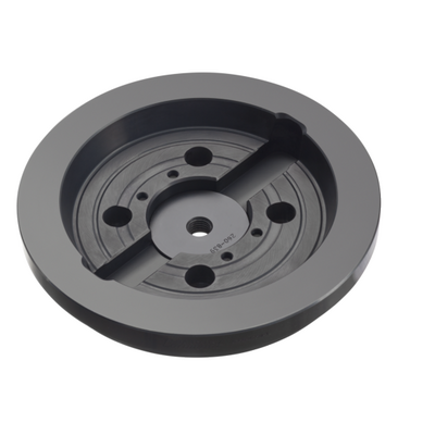

Support body
ISO: 260-431M-1
Material Id: 5757532
EAN: 10157221
ANSI: 260-431M-1

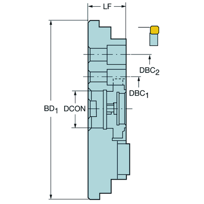

Arbor -ISO 6462 -C (8 bolts) -metric: 60D
Connection - workpiece side
(ADINTWS)
Cap mounting -metric: 315
Coolant exit style
60 mm
Standard number
(STDNO)
ISO6462
Standard letter
(STDLET)
C
Diameter bolt circle
(DBC)
101.6 mm
Connection diameter workpiece side
(DCONWS)
267.6 mm
Kappa (z-axis rot)
(KAP)
80 mm
Body diameter
(BD_1)
228 mm
Body diameter
(BD_2)
267.6 mm
Body diameter
(BD_3)
287.4 mm
Body length
(LB_1)
25 mm
Body length
(LB_2)
44 mm
Body length
(LB_3)
61 mm
Body half taper angle
(BHTA_1)
(BHTA_2)
(BHTA_3)
Body material
Steel
Balancing method code
(BLMC)
No balancing
30.7 kg
80 mm
