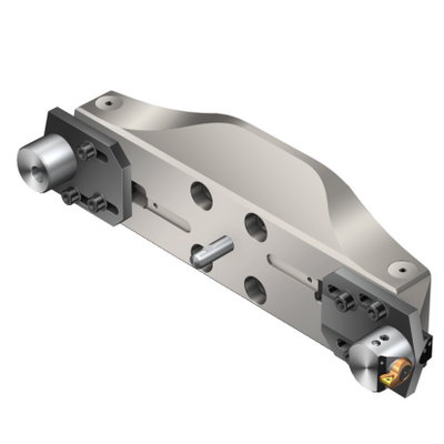

CoroBore® 825 XL fine boring tool
ISO: 825-555TC11
Material Id: 6352249
EAN: 26352249
ANSI: 825-555TC11
Minimum cutting diameter
(DCN)
458 mm
Maximum cutting diameter
(DCX)
555 mm
Maximum adjustment limit
(ADJLX)
48.5 mm
Tool cutting edge angle
(KAPR)
92 °
Cutting item count
(CICT)
1
Clamping type code
Insert type
TCMT 110304 (RE<0.4)
CoroBore XL Arbor -metric: 40X
Coolant pressure
70 bar
40 mm
Hub diameter
(DHUB)
160 mm
Diameter bolt circle
(DBC)
101.6 mm
124 mm
Body diameter
(BD)
455 mm
Body length
(LB)
124 mm
124 mm
Overall height
(OAH)
164 mm
0.9 Nm
Body material
Steel and aluminium
13.19 kg
1/4
Insert seat
11
23/02/2013
