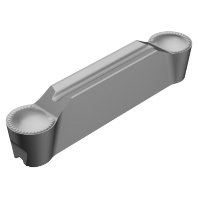

C2I-H2N-0500-RM 1205content_copy
Package quantity: 5
ISO: C2I-H2N-0500-RM 1205file_copy
Material Id: 8480023file_copy
EAN: 7323227732657file_copy
ANSI: C2I-H2N-0500-RM 1205file_copy
Start values
M1.0.Z.AQHardness: 200 HB
m schematic icon of x direction insertfn 0.14  mm/r   (0.06 - 0.24)
vc 180  m/min   (235 - 150)
schematic icon of z direction insertap 1.2  mm   (0.2 - 1.6)
fn 0.44  mm/r   (0.23 - 0.68)
vc 140  m/min   (170 - 120)
S2.0.Z.AGHardness: 350 HB
s schematic icon of x direction insertfn 0.14  mm/r   (0.06 - 0.24)
vc 80  m/min   (110 - 60)
schematic icon of z direction insertap 1  mm   (0.2 - 1.4)
vc 45  m/min   (85 - 29)
m
s
ap 1  mm   (0.2 - 1.4)
MNSSearch Icon
Chip breaker(CBMD)info
RMSearch Icon
Operation type (CTPT)info
Concave prismatic section with railSearch Icon
CoroCut 1-2 -size H2Search Icon
Cutting edge count(CEDC)info
2Search Icon
Insert seat(SSC_M)info
HSearch Icon
Cutting width (CW)info
5 mmSearch Icon
Cutting width lower tolerance(CWTOLL)info
-0.045 mmSearch Icon
Cutting width upper tolerance(CWTOLU)info
0.045 mmSearch Icon
Corner radius (RE)info
2.5 mmSearch Icon
Corner radius lower tolerance(RETOLL)info
-0.05 mmSearch Icon
Corner radius upper tolerance(RETOLU)info
0.05 mmSearch Icon
Cutting depth maximum (CDX)info
22.87 mmSearch Icon
2.3 mmSearch Icon
Hand (HAND)info
NeutralSearch Icon
Grade (GRADE)info
1205Search Icon
Coating(COATING)info
PVD AlTiNSearch Icon
Insert thickness(S)info
4.35 mmSearch Icon
Clearance angle major(AN)info
7 °Search Icon
Insert gauge length(LIG)info
25.11 mmSearch Icon
Weight of item(WT)info
0.0062 kgSearch Icon
HSearch Icon
30/05/2024Search Icon
24.2Search Icon
