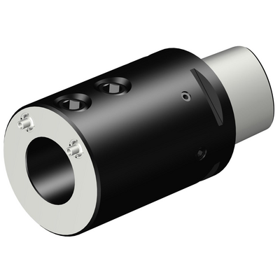

Coromant Capto® to cylindrical shank adaptor
Specific representation
List price:
749.00 GBP
ISO: C8-131-00112-40
Material Id: 5730009
EAN: 11778550
ANSI: C8-131-00112-40
Connection - workpiece side
(ADINTWS)
Cylindrical clamping w/ flats (sleeve) -metric: 40
Minimum overhang
(OHN)
112 mm
Maximum overhang
112 mm
Coolant exit style
axial concentric exit
Coolant pressure
80 bar
80 mm
Connection diameter workpiece side
(DCONWS)
40 mm
(LF_1)
112 mm
Functional width
(WF_1)
Functional height
(HF_1)
Body diameter
(BD_1)
80 mm
Body length
(LB)
112 mm
160 mm
Maximum tool changer interference diameter
(DIX)
80 mm
50 Nm
Body material
Steel
4.19 kg
