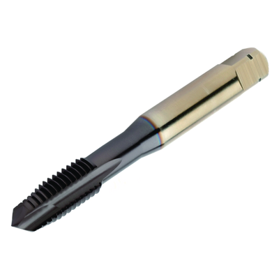

ISO: E049M8file_copy
Material Id: 6182567file_copy
EAN: 26182567file_copy
ANSI: E049M8file_copy
PSearch Icon
Thread size(TDZ)info
M 8Search Icon
Thread form(THFT)info
M (Metric 60°)Search Icon
Tap chamfer length(TCL)info
5.4077 mmSearch Icon
Thread pitch(TP)info
1.25 mmSearch Icon
Thread diameter(TD)info
8 mmSearch Icon
Premachined hole diameter(PHD)info
6.8 mmSearch Icon
through holeSearch Icon
Hole type(HTY)info
Thread tolerance class(TCTR)info
6HSearch Icon
Shank standard group(BSG)info
ISO 529Search Icon
Usable length (LU)info
29 mmSearch Icon
Tap shank ISO -metric: 8.00 x 6.30Search Icon
Chip breaker(CBMD)info
PMSearch Icon
Grade (GRADE)info
T3J8Search Icon
Substrate(SUBSTRATE)info
HSS-PMSearch Icon
Coating(COATING)info
PVD TiAlNSearch Icon
Coolant entry style(CNSC)info
Coolant exit style(CXSC)info
no coolant exitSearch Icon
Connection diameter machine side(DCONMS)info
8 mmSearch Icon
Connection diameter tolerance(TCDCON)info
h9Search Icon
Functional length(LF)info
72 mmSearch Icon
Neck diameter(DN)info
5.75 mmSearch Icon
Flute count(NOF)info
3Search Icon
Flute helix angle(FHA)info
Radial rake angle(GAMF)info
9 °Search Icon
Threading length(THL)info
16.3 mmSearch Icon
Threading chamfer type(THCHT)info
B = 3.5-5xTP GunnoseSearch Icon
Weight of item(WT)info
0.0272 kgSearch Icon
Overall length(OAL)info
74.9 mmSearch Icon
