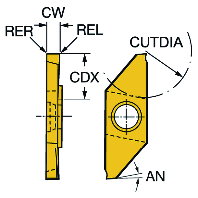

Insert size and shape
CoroCut XS -size 3R
Cutting edge count
Insert seat
3
Cutting width
(CW)
1 mm
Cutting width lower tolerance
(CWTOLL)
-0.02 mm
Cutting width upper tolerance
(CWTOLU)
0.02 mm
Corner radius left
(REL)
0.05 mm
Corner radius right
(RER)
0.05 mm
Corner radius lower tolerance
(RETOLL)
-0.03 mm
Corner radius upper tolerance
(RETOLU)
0.03 mm
Cutting depth maximum
6.3 mm
