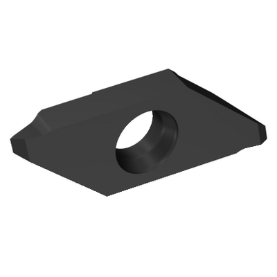

CoroCut® XS insert for thread turning
Available within a week
Package quantity: 5
ISO: MATR 3 60-N 1105
Material Id: 5735467
EAN: 12456570
ANSI: MATR 3 60-N 1105

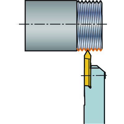

Thread form
(THFT)
M (Metric 60°), MF 60°, UN 60°, UNC 60°, UNF 60°
Thread type
(TTP)
external

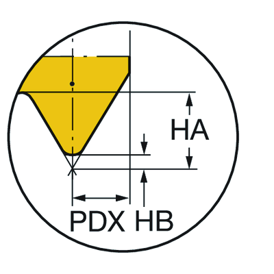

Theoretical thread height
(HA)
1.5 mm
Thread height difference
(HB)
0.05 mm
Profile distance ex
(PDX)
1.59 mm

Insert mounting style code
Fixing hole diameter
4.8 mm
Insert size and shape
CoroCut XS -size 3R
Cutting edge count
Corner radius
0.05 mm
1105
PVD TiAlN
Insert thickness
3.175 mm
0.0047 kg
