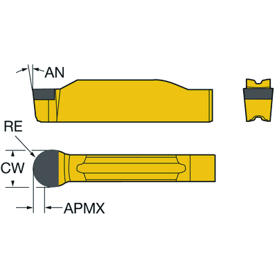

Chip breaker(CBMD)info
RESearch Icon
Operation type (CTPT)info
finishingSearch Icon
Concave prismatic sectionSearch Icon
CoroCut 1-2 -size F1Search Icon
Cutting edge count(CEDC)info
1Search Icon
Insert seat(SSC_M)info
FSearch Icon
Cutting width (CW)info
3 mmSearch Icon
Cutting width lower tolerance(CWTOLL)info
-0.02 mmSearch Icon
Cutting width upper tolerance(CWTOLU)info
0.02 mmSearch Icon
Corner radius (RE)info
1.5 mmSearch Icon
Corner radius lower tolerance(RETOLL)info
-0.02 mmSearch Icon
Corner radius upper tolerance(RETOLU)info
0.02 mmSearch Icon
0.6 mmSearch Icon
Hand (HAND)info
NeutralSearch Icon
Grade (GRADE)info
7025Search Icon
Insert thickness(S)info
4.3321 mmSearch Icon
Clearance angle major(AN)info
7 °Search Icon
Weight of item(WT)info
0.002 kgSearch Icon
