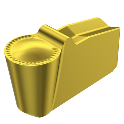

N151.2-500-40-5P 235content_copy
Package quantity: 10
ISO: N151.2-500-40-5P 235file_copy
Material Id: 5737214file_copy
EAN: 10542431file_copy
ANSI: N151.2-500-40-5P 235file_copy
Start values
P2.1.Z.ANHardness: 175 HB
p schematic icon of x direction insertfn 0.15  mm/r   (0.1 - 0.2)
vc 125  m/min   (135 - 125)
schematic icon of z direction insertfn 0.57  mm/r   (0.3 - 0.89)
M1.0.Z.AQHardness: 200 HB
m schematic icon of x direction insertfn 0.15  mm/r   (0.1 - 0.2)
vc 100  m/min   (105 - 100)
m
PMSSearch Icon
Chip breaker(CBMD)info
5PSearch Icon
Operation type (CTPT)info
Concave prismatic sectionSearch Icon
Q-Cut 151.2 -size 40Search Icon
Cutting edge count(CEDC)info
1Search Icon
Insert seat(SSC_M)info
40Search Icon
Cutting width (CW)info
5 mmSearch Icon
Cutting width lower tolerance(CWTOLL)info
-0.05 mmSearch Icon
Cutting width upper tolerance(CWTOLU)info
0.05 mmSearch Icon
Corner radius (RE)info
2.5 mmSearch Icon
Corner radius lower tolerance(RETOLL)info
-0.025 mmSearch Icon
Corner radius upper tolerance(RETOLU)info
0.025 mmSearch Icon
2.2 mmSearch Icon
Hand (HAND)info
NeutralSearch Icon
Grade (GRADE)info
235Search Icon
Coating(COATING)info
CVD TiCN+TiNSearch Icon
Insert thickness(S)info
8.106 mmSearch Icon
Clearance angle major(AN)info
7 °Search Icon
Weight of item(WT)info
0.0024 kgSearch Icon
