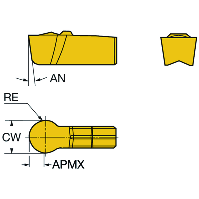

Concave prismatic sectionSearch Icon
Q-Cut 151.3face -size 25Search Icon
Cutting edge count(CEDC)info
1Search Icon
Insert seat(SSC_M)info
25Search Icon
Cutting width (CW)info
3 mmSearch Icon
Cutting width lower tolerance(CWTOLL)info
-0.05 mmSearch Icon
Cutting width upper tolerance(CWTOLU)info
0.05 mmSearch Icon
Corner radius (RE)info
1.5 mmSearch Icon
Corner radius lower tolerance(RETOLL)info
-0.02 mmSearch Icon
Corner radius upper tolerance(RETOLU)info
0.02 mmSearch Icon
1.3 mmSearch Icon
Hand (HAND)info
NeutralSearch Icon
Grade (GRADE)info
1125Search Icon
Coating(COATING)info
PVD TiAlNSearch Icon
Insert thickness(S)info
5.287 mmSearch Icon
Clearance angle major(AN)info
9 °Search Icon
Weight of item(WT)info
0.0005 kgSearch Icon
