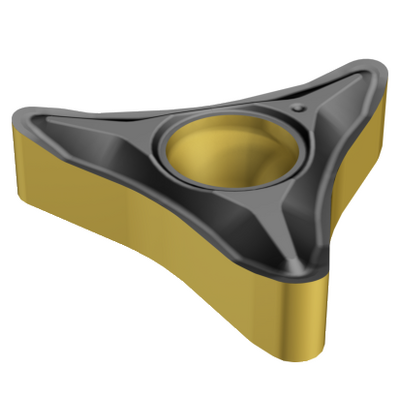

Chip breaker
F5
Operation type
finishing
Fixing hole diameter
2.8 mm

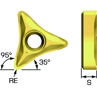

Insert size and shape
CoroTurn PRIME PI-A06
Cutting edge count
3
Inscribed circle diameter
6 mm
Corner radius
0.8 mm
Major cutting edge angle
(KRINS)
95 °
Face land width
(BN)
0.26 mm
Insert rake angle
(GAN)
15 °
4415
CVD TiCN+Al2O3+TiN
Insert thickness
3 mm
