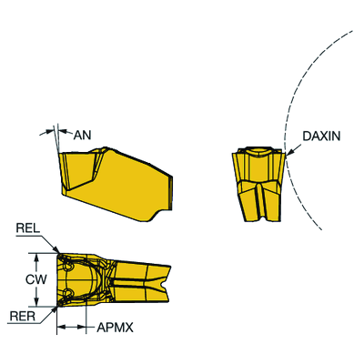

Start values
P2.1.Z.ANHardness: 175 HB
p schematic icon of x direction insertfn 0.1  mm/r   (0.05 - 0.25)
vc 175  m/min   (240 - 145)
schematic icon of z direction insertap 1.1  mm   (0.4 - 2)
fn 0.15  mm/r   (0.05 - 0.3)
vc 170  m/min   (240 - 135)
M1.0.Z.AQHardness: 200 HB
m schematic icon of x direction insertfn 0.1  mm/r   (0.05 - 0.25)
vc 145  m/min   (195 - 115)
vc 140  m/min   (195 - 110)
K2.2.C.UTHardness: 245 HB
k schematic icon of x direction insertfn 0.1  mm/r   (0.05 - 0.25)
vc 120  m/min   (160 - 100)
vc 120  m/min   (160 - 95)
S2.0.Z.AGHardness: 350 HB
s schematic icon of x direction insertfn 0.1  mm/r   (0.05 - 0.25)
vc 33  m/min   (45 - 27)
vc 32  m/min   (45 - 26)
ap 1.1  mm   (0.4 - 2)
m
ap 1.1  mm   (0.4 - 2)
k
ap 1.1  mm   (0.4 - 2)
s
ap 1.1  mm   (0.4 - 2)
PMKNSSearch Icon
Chip breaker(CBMD)info
TFSearch Icon
Operation type (CTPT)info
finishingSearch Icon
Concave prismatic sectionSearch Icon
CoroCut QFT -size GSearch Icon
Cutting edge count(CEDC)info
1Search Icon
Insert seat(SSC_M)info
QFT-GSearch Icon
Cutting width (CW)info
3 mmSearch Icon
Cutting width lower tolerance(CWTOLL)info
-0.05 mmSearch Icon
Cutting width upper tolerance(CWTOLU)info
0.05 mmSearch Icon
Spot chamfer(CF)info
2.4 mmSearch Icon
Corner radius left(REL)info
0.3 mmSearch Icon
Corner radius right(RER)info
0.3 mmSearch Icon
Corner radius lower tolerance(RETOLL)info
-0.05 mmSearch Icon
Corner radius upper tolerance(RETOLU)info
0.05 mmSearch Icon
Axial groove inside diameter minimum(DAXIN)info
30 mmSearch Icon
2 mmSearch Icon
Hand (HAND)info
NeutralSearch Icon
Grade (GRADE)info
1125Search Icon
Coating(COATING)info
PVD TiAlNSearch Icon
Insert thickness(S)info
3.5 mmSearch Icon
Clearance angle major(AN)info
7 °Search Icon
Weight of item(WT)info
0.0003 kgSearch Icon
QFT-GSearch Icon
22/02/2018Search Icon
18.1Search Icon
