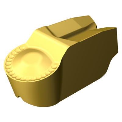

QFU-G-0300-RM 1135content_copy
QFU-G-0300-RM 1135
Package quantity: 10
ISO: QFU-G-0300-RM 1135file_copy
Material Id: 7193306file_copy
EAN: 7323221539436file_copy
ANSI: QFU-G-0300-RM 1135file_copy
Start values
P2.1.Z.ANHardness: 175 HB
p schematic icon of x direction insertfn 0.08  mm/r   (0.05 - 0.12)
vc 150  m/min   (180 - 135)
schematic icon of z direction insertap 0.75  mm   (0.1 - 1.2)
fn 0.49  mm/r   (0.28 - 0.71)
vc 90  m/min   (110 - 80)
M1.0.Z.AQHardness: 200 HB
m schematic icon of x direction insertfn 0.08  mm/r   (0.05 - 0.12)
vc 125  m/min   (150 - 110)
vc 75  m/min   (90 - 65)
K2.2.C.UTHardness: 245 HB
k schematic icon of x direction insertfn 0.08  mm/r   (0.05 - 0.12)
vc 100  m/min   (120 - 95)
vc 65  m/min   (80 - 60)
m
k
PMKSSearch Icon
Chip breaker(CBMD)info
RMSearch Icon
Operation type (CTPT)info
Concave prismatic sectionSearch Icon
CoroCut QFU -size GSearch Icon
Cutting edge count(CEDC)info
1Search Icon
Insert seat(SSC_M)info
QFU-GSearch Icon
Cutting width (CW)info
3 mmSearch Icon
Cutting width lower tolerance(CWTOLL)info
-0.05 mmSearch Icon
Cutting width upper tolerance(CWTOLU)info
0.05 mmSearch Icon
Corner radius (RE)info
1.5 mmSearch Icon
Axial groove inside diameter minimum(DAXIN)info
30 mmSearch Icon
1.3 mmSearch Icon
Hand (HAND)info
NeutralSearch Icon
Grade (GRADE)info
1135Search Icon
Coating(COATING)info
CVD TiCrN+Al2O3+TiNSearch Icon
Insert thickness(S)info
3.5 mmSearch Icon
Clearance angle major(AN)info
7 °Search Icon
Weight of item(WT)info
0.0007 kgSearch Icon
QFU-GSearch Icon
22/09/2018Search Icon
18.2Search Icon
