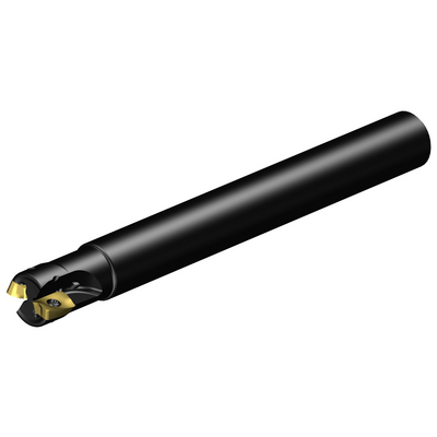

R390-016A16L-11Lcontent_copy
R390-016A16L-11L
List price: 40.25 EURfile_copy
Package quantity: 10
ISO: R390-016A16L-11Lfile_copy
Material Id: 5725824file_copy
EAN: 10621144file_copy
ANSI: CNMM 644-HR 235file_copy
Start values  (KAPR  95 deg )
P2.1.Z.AN, Hardness: 175 HB
ap 10  mm   (2.4 - 13)
fn 0.8  mm/r   (0.5 - 1.1)
hex 0.8  mm/r   (0.5 - 1.1)
vc 75  m/min   (95 - 60)
M1.0.Z.AQ, Hardness: 200 HB
ap 10  mm   (2.4 - 13)
vc 65  m/min   (90 - 50)
Search Icon
Chip breaker(CBMD)info
HRSearch Icon
Operation type (CTPT)info
roughingSearch Icon
Fixing hole diameter(D1)info
7.925 mmSearch Icon
CN1906Search Icon
Cutting edge count(CEDC)info
2Search Icon
19.05 mmSearch Icon
Insert shape code(SC)info
Rhombic 80Search Icon
17.7439 mmSearch Icon
Corner radius (RE)info
1.5875 mmSearch Icon
Hand (HAND)info
NeutralSearch Icon
Grade (GRADE)info
235Search Icon
Substrate(SUBSTRATE)info
HCSearch Icon
Coating(COATING)info
CVD TiCN+TiNSearch Icon
Insert thickness(S)info
6.35 mmSearch Icon
Clearance angle major(AN)info
Weight of item(WT)info
0.0262 kgSearch Icon
Insert seat(SSC_M)info
19Search Icon
3/4Search Icon
02/11/1992Search Icon
92.3Search Icon
