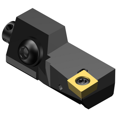

CoroTurn® 107, cartridge for turning
Specific representation
ISO: SCFCL 12CA-09
Material Id: 5749014
EAN: 12026663
ANSI: SCFCL 12CA-09
Tool cutting edge angle
(KAPR)
Coolant exit style
Lead angle
Clamping type code
Cartridge (ISO5611) -left hand: 12CA
Insert type
CCMT 09T308
Minimum bore diameter
50 mm
Maximum overhang
55 mm
Shank width
15 mm
Shank height
20 mm
Mounting hole distance
(MHD)
20 mm
55 mm
Functional width
20 mm
Functional height
12 mm
3 Nm
0.0987 kg
55 mm
Insert seat
09
3/8
