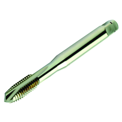

T200-NM100DA-M6 B150
CoroTap® 200, cutting tap with spiral point

ISO: T200-NM100DA-M6 B150
Material Id: 7605859
EAN: 7323223902917
ANSI: T200-NM100DA-M6 B150
Start values
N1.3.C.AG
Hardness: 90 HB
N
20 m/min
N
Thread size
(TDZ)
M 6
Thread form
(THFT)
M (Metric 60°)
Tap chamfer length
(TCL)
4.081 mm
Thread pitch
(TP)
1 mm
Thread diameter
(TD)
6 mm
Premachined hole diameter
(PHD)
5 mm
Premachined hole type
(PHT)
through hole
Hole type
(HTY)
through hole
Thread tolerance class
(TCTR)
6H
Shank standard group
(BSG)
DIN 371
Usable length
27 mm
Tap shank DIN -metric: 6.00 x 4.90
Chip breaker
NM
B150
HSS-E
Coolant exit style
6 mm
Connection diameter tolerance
(TCDCON)
h9
80 mm
Neck diameter
(DN)
4.6 mm
Flute count
(NOF)
3
Flute helix angle
(FHA)
Radial rake angle
(GAMF)
7 °
Threading length
(THL)
15 mm
Threading chamfer type
(THCHT)
B = 3.5-5xTP Gunnose
0.017 kg
82.4 mm
