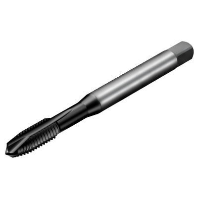

CoroTap® 200, cutting tap with spiral point
List price:
96.20 GBP
Out of stock
ISO: T200-PM108DA-M10 P1PM
Material Id: 8060698
EAN: 7323225979689
ANSI: T200-PM108DA-M10 P1PM
Start values
P2.1.Z.AN
Hardness: 175 HB
40 m/min
Thread size
(TDZ)
M 10
Thread form
(THFT)
M (Metric 60°)
Tap chamfer length
(TCL)
6.5731 mm
Thread pitch
(TP)
1.5 mm
Thread diameter
(TD)
10 mm
Premachined hole diameter
(PHD)
8.5 mm
Premachined hole type
(PHT)
through hole
Hole type
(HTY)
through hole
Thread tolerance class
(TCTR)
6HX
Shank standard group
(BSG)
DIN371

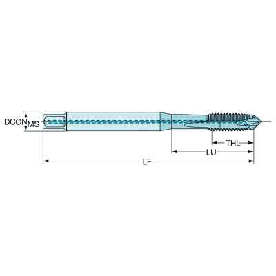

Usable length
39 mm
Tap shank DIN -metric: 10.00 x 8.00
Chip breaker
PM
P1PM
HSS-E-PM
PVD TiAlN
Coolant exit style
radial exit
10 mm
100 mm
Flute count
(NOF)
3
Flute helix angle
(FHA)
Radial rake angle
(GAMF)
9 °
Threading length
(THL)
20 mm
Thread back taper property
(THBTP)
Yes
Threading chamfer type
(THCHT)
B = 3.5-5xTP Gunnose
0.052 kg
100 mm
