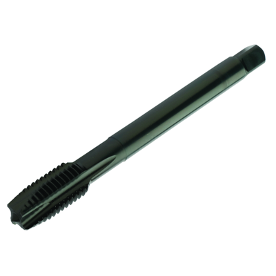

CoroTap® 200, cutting tap with spiral point
List price:
29.35 GBP
Made-to-order
ISO: T200-SD101JA-M8 D150
Material Id: 8248660
EAN: 7323226761115
ANSI: T200-SD101JA-M8 D150
Start values
S2.0.Z.AG
Hardness: 350 HB
10 sfm
Thread size
(TDZ)
M 8
Thread form
(THFT)
M (Metric 60°)
Tap chamfer length
(TCL)
0.2195 inch
Thread pitch
(TP)
0.0492 inch
Thread diameter
(TD)
0.315 inch
Premachined hole diameter
(PHD)
0.2677 inch
Premachined hole type
(PHT)
through hole
Hole type
(HTY)
through hole
Thread tolerance class
(TCTR)
6HX
Shank standard group
(BSG)
JIS-B-4430
Usable length
1.378 inch
Tap shank JIS -metric: 6.20 x 5.00
Chip breaker
SD
D150
HSS-E-PM
Coolant exit style
0.2441 inch
2.7559 inch
Neck diameter
(DN)
0.2346 inch
Flute count
(NOF)
3
Flute helix angle
(FHA)
Radial rake angle
(GAMF)
2 °
Threading length
(THL)
0.7087 inch
Thread back taper property
(THBTP)
Yes
Threading chamfer type
(THCHT)
B = 3.5-5xTP Gunnose
0.0419 lb
2.7559 inch
