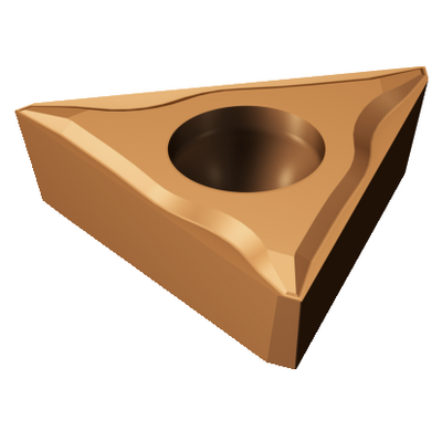

TCEX 05 01 01R-F 1125
Package quantity: 10
ISO: TCEX 05 01 01R-F 1125
Material Id: 5752352
EAN: 12344054
ANSI: TCEX 1(1)03R-F 1125
Start values
93 deg
M1.0.Z.AQ
Hardness: 200 HB
m
0.15 mm (0.05 - 0.8)
0.06 mm/r (0.02 - 0.1)
205 m/min (205 - 205)
N
Chip breaker
F
Operation type
finishing
Fixing hole diameter
2.25 mm
Insert size and shape
TC0501
Cutting edge count
3
Inscribed circle diameter
3.175 mm
Insert shape code
Triangular
Cutting edge effective length
5.47 mm
Corner radius
0.1 mm
1125
PVD TiAlN+TiAlN
Insert thickness
1.4 mm
Clearance angle major
7 °
0.0014 kg
Insert seat
05
1/8
