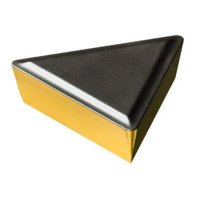

TPMR 22 04 12 4325
TPMR 22 04 12 4325
TPMR 22 04 12 4325
T-Max® S, insert for turning
Being replaced by
TPMR 22 04 12 4425
Package quantity: 10
ISO: TPMR 22 04 12 4325
Material Id: 6532294
EAN: 26532294
ANSI: TPMR 433 4325
Start values
92 deg
P2.1.Z.AN
Hardness: 175 HB
2.5 mm (1 - 4)
0.35 mm/r (0.3 - 0.5)
295 m/min (310 - 255)
K2.2.C.UT
Hardness: 245 HB
k
2.5 mm (1 - 4)
170 m/min (185 - 140)
Chip breaker
53
Operation type
finishing
Without fixing hole
Insert size and shape
TP2204
Cutting edge count
3
Inscribed circle diameter
12.7 mm
Insert shape code
Triangular
Cutting edge effective length
20.797 mm
Corner radius
1.1906 mm
4325
CVD TiCN+Al2O3+TiN
Insert thickness
4.7625 mm
Clearance angle major
11 °
0.0109 kg
Insert seat
22
