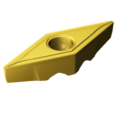

CoroTurn® TR, insert for turning
New
Package quantity: 10
ISO: TR-VB1304-F 1625
Material Id: 8864632
EAN: 7323228974636
ANSI: TR-VB1304-F 1625
Start values
93 deg
P2.1.Z.AN
Hardness: 175 HB
0.8 mm (0.1 - 2)
0.15 mm/r (0.06 - 0.35)
290 m/min (375 - 205)
M1.0.Z.AQ
Hardness: 200 HB
m
0.8 mm (0.1 - 2)
0.15 mm/r (0.06 - 0.25)
190 m/min (210 - 170)
Chip breaker
F
Operation type
finishing
40°-60° countersunk hole, rail bottom
Fixing hole diameter
3.4 mm
Insert size and shape
CoroTurn TR VB13
Cutting edge count
Inscribed circle diameter
8 mm
Insert shape code
Rhombic 35
Cutting edge effective length
12.6 mm
Corner radius
0.3969 mm
Face land width
(BN)
0.07 mm
Face land angle
(GB)
Insert rake angle
(GAN)
18 °
1625
PVD TiAlN+TiN
Insert thickness
4.525 mm
Clearance angle major
5 °
0.0015 kg
Insert seat
13
