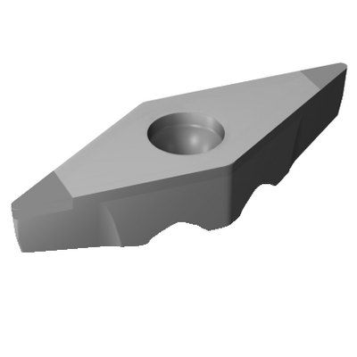

CoroTurn® TR, insert for turning
Package quantity: 5
ISO: TR-VB1312EF 7014
Material Id: 7992860
EAN: 7323225661355
ANSI: TR-VB1312EF 7014

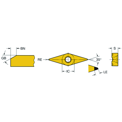

Insert size and shape
CoroTurn TR VB13
Cutting edge count
Inscribed circle diameter
8 mm
Insert shape code
Rhombic 35
Cutting edge effective length
2.13 mm
Corner radius
1.191 mm
Insert rake angle
(GAN)
7014
BL
Insert thickness
4.525 mm
Clearance angle major
5 °
