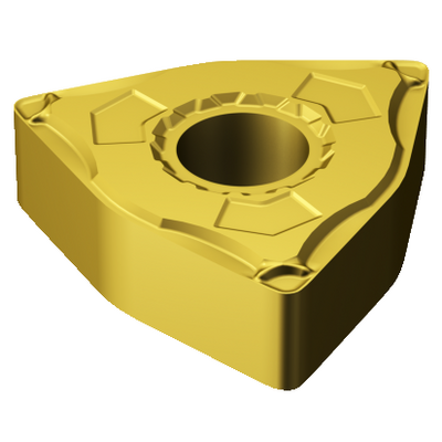

WNMG 08 04 08-LC 1525
T-Max® P, insert for turning
Being replaced by
WNMG 08 04 08-LC 1625
Package quantity: 10
ISO: WNMG 08 04 08-LC 1525
Material Id: 5756503
EAN: 12170981
ANSI: WNMG 432-LC 1525
Start values
95 deg
P2.1.Z.AN
Hardness: 175 HB
0.5 mm (0.2 - 1.5)
0.22 mm/r (0.11 - 0.32)
0.2 mm/r (0.1 - 0.3)
260 m/min (330 - 220)
Chip breaker
LC
Operation type
finishing
Cylindrical fixing hole
Fixing hole diameter
5.156 mm
Insert size and shape
WN0804
Cutting edge count
6
Inscribed circle diameter
12.7 mm
Insert shape code
Trigon 80
Cutting edge effective length
7.8873 mm
Corner radius
0.7938 mm
1525
PVD TiCN+TiN
Insert thickness
4.7625 mm
Clearance angle major
0.0029 kg
Insert seat
08
14/08/2006
06.2
