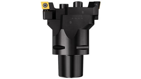

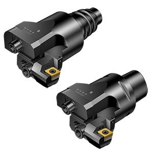

Back boring enable machining of a hole with a shoulder that cannot be reached from the opposite direction. It can also be used to optimize concentricity of a hole with a shoulder since the entire hole is machined from only one position.
High-precision coolant
Coolant nozzles with high precision capability built into slide for precise coolant direction. Available up to 80 bar (1160 psi).
Modular interfaces
Modularity with Coromant Capto® and Coromant EH.

CoroBore® BR10 single-edge back boring
CoroBore BR10 is based on the CoroBore BR20 adaptor together with a unique back boring slide and cover. Available as complete back boring assembly kit or separate back boring slide and cover as additional items.
