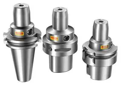

Productivity is not only influenced by grade and geometry, but also by the ability to clamp the tool securely and precisely. For best stability and hole quality always use Coromant Capto® or CoroChuck® 930 with the shortest possible drill and overhang.

  • It is recommended to use hydraulic precision chucks
