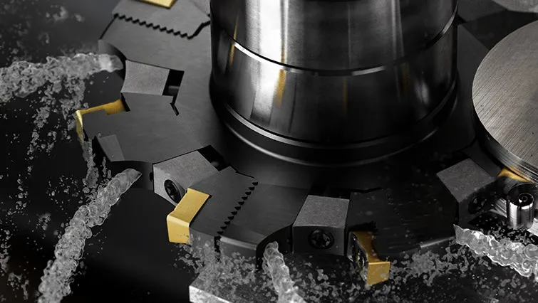

GC1230
Grade GC1230 is optimized for light roughing to finishing operations in steel milling. It covers general applications to challenging applications such as square shoulder, complex tool paths and deep cavities. This grade excels in both edge line toughness and wear resistance, allowing you to go for longer tool life, higher productivity or machine with a more sustainable approach.
Features and benefits
  • Innovative nano-multilayer coating produced with recognized Zertivo® PVD coating process technology
  • Superior edge line strength means increased tool life, predictability and security
  • Optimized cutting-edge integrity improves wear resistance and reduces flaking and chipping
  • High heat resistance enables higher metal removal rates, even in challenging applications
  • Excellent performance in both dry and wet machining conditions — run dry for a more sustainable process

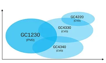

​Find your grade
Our steel insert grade assortment consists of CVD- and PVD-coated carbide grades and uncoated cermets for various machining conditions.
Stable conditions
Unstable conditions
Low heat                                                High heat
(Small cutters                                   (Large cutters
and/or low vc, ae)                              and/or high vc, ae)
GC1230
Nano multi-layer PVD-coated grade produced with Zertivo® technology. Designed for light roughing to finishing operations,  both for wet and dry machining. Good choice for complex tool paths and sticky materials.

GC1130
Hard, thin coated PVD-grade with Zertivo® technology for various applications. Suitable from light roughing to finishing in average stability for wet and dry machining. Good choice for complex tool paths and sticky materials.

GC4330
Medium hard CVD-coated grade (medium to thick coating) designed for medium to rough milling applications in average cutting conditions for wet and dry machining.

GC4340
Tough CVD-coated grade (medium thick coating) suited for tough and demanding medium to rough milling applications for wet and dry machining.

GC4220
Hard CVD-coated (thick coated) grade suitable for high cutting speeds in medium to rough milling application with good stability for dry machining.
