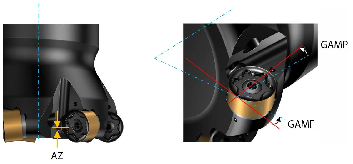

| Cutter body Ø | Ramping angle RMPX | Max plunge depth AZ, mm (inch) | Radial tilt GAMF | Axial tilt GAMP |
| 32 mm (H) | 0.86° | 0.15 (0.006) | -19° | -7° |
| 40 mm (H) | 0.86° | 0.27 (0.011) | -15° | -7° |
| 50 mm (M / H) | 0.74° | 0.36 (0.014) | -12° / -14° | -7° |
| 63 mm (M / H) | 0.59° | 0.42 (0.017) | -12° / -14° | -7° |
| 80 mm (M / H) | 0.43º | 0.44 (0.017) | -14° / -12° | -7° |
| 100 mm (M / H) | 0.33° | 0.44 (0.017) | -14° / -12° | -7° |
| 2 inch (M / H) | 0.74° | 0.36 (0.014) | -12° / -14° | -7° |
| 2 ½ inch (M) | 0.59° | 0.42 (0.017) | -12° | -7° |
| 3 inch (M) | 0.43º | 0.44 (0.017) | -14° | -7° |
| 4 inch (M) | 0.33° | 0.44 (0.017) | -14° | -7° |
