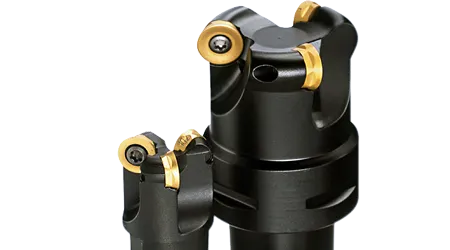

Toroid cutters
The toroid end mills operate with two overlapping round inserts. This design prevents the cutting speed to drop to zero, as with a ball nose cutter.
Safe cutting action and accessibility in narrow pocket milling
- Toroid cutters can considerably improve productivity and are very suitable for light roughing, rest milling and semi-finishing operations
- Excellent for profiling, when a constant stock is a prerequisite for milling near net shape
