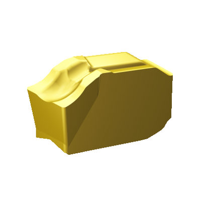

QD-LH-0400-0502-CM 1135file_copy
Package quantity: 10
ISO: QD-LH-0400-0502-CM 1135file_copy
Material Id: 6398209file_copy
EAN: 26398209file_copy
ANSI: QD-LH-0400-0502-CM 1135file_copy
Start values  (Primary (Radial) KAPR 85 deg)
fn0.11  mm/r  (0.07 - 0.21)
vc125  m/min  (160 - 110)
m
vc105  m/min  (135 - 90)
s
vc26  m/min  (32 - 23)
PMKSSearch Icon
Chip breaker(CBMD)info
CMSearch Icon
Operation type (CTPT)info
Insert mounting style code(IFS)info
Concave prismatic sectionSearch Icon
CoroCut QD -size HSearch Icon
Cutting edge count(CEDC)info
1Search Icon
Insert seat - metric(SSC_M)info
HSearch Icon

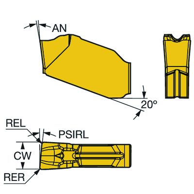

Cutting width (CW)info
4 mmSearch Icon
Cutting width lower tolerance(CWTOLL)info
-0.05 mmSearch Icon
Cutting width upper tolerance(CWTOLU)info
0.05 mmSearch Icon
Corner radius left(REL)info
0.2 mmSearch Icon
Corner radius right(RER)info
0.2 mmSearch Icon
Corner radius lower tolerance(RETOLL)info
-0.05 mmSearch Icon
Corner radius upper tolerance(RETOLU)info
0.05 mmSearch Icon
Major left hand cutting edge angle(PSIRL)info
5 °Search Icon
Hand (HAND)info
Grade (GRADE)info
1135Search Icon
Coating(COATING)info
CVD TiCrN+Al2O3+TiNSearch Icon
Insert thickness(S)info
4 mmSearch Icon
Clearance angle major(AN)info
7 °Search Icon
Weight of item(WT)info
0.0028 kgSearch Icon
HSearch Icon
9/24/13Search Icon
13.2Search Icon
