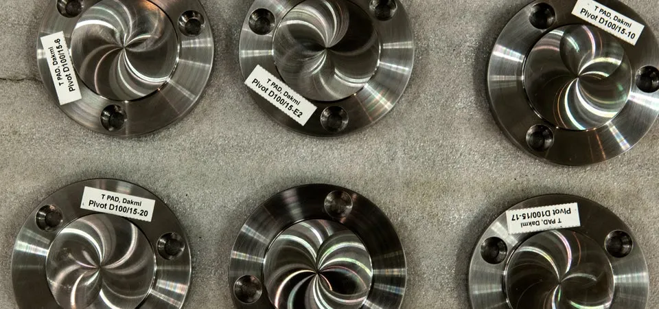

Until 2013, Omega Renk had been purchasing forged steel rings and cutting them into 16 sections with a bandsaw, then milling each guide pad individually. But cost pressure from competitors forced the company to rethink the process so that the milling could be done on the ring itself. Using a slitting cutter, the almost-finished guide pads could then be sliced off the ring in the final step of milling.
At that time, however, Sandvik Coromant’s product range didn’t include a parting off tool that met the needs Omega Renk. And even though the change in process had resulted in a cost savings of around 15 percent, Prakash still wasn’t happy. The tool he’d settled for from a Sandvik Coromant competitor could only cut at very low speeds; at higher speeds it would get stuck. The machine had to make two or three passes, and there was so much noise and vibration that the operator was always worried about the impact on the costly equipment. “With a CNC machine, you want it to run smooth,” Prakash says.

With the CoroMill QD and the Coromant Capto® C8 adaptor, Omega Renk achieved a cutting speed increase of nearly 60 percent, resulting in an improvement in feed rate from 200 millimetres to 320 millimetres and an added overall cost reduction of around 4 percent – excluding any potential savings in broken inserts or wear and tear on the CNC machine. “The biggest gain was that the process became very stable,” Prakash says.

After studying the application, fixture and problems with the existing setup, Sandvik Coromant sales representative Ramchandra Soni suggested the CoroMill QD with the Coromant Capto C8 adaptor. “This product is the only grooving cutter on the market with an internal coolant, optimized milling geometries and periphery-ground inserts,” Soni says. “Those features ensure high-quality grooves and eliminate the chip-jamming issues Omega Renk was previously facing, so we were able to improve the feed rate from 200 millimetres to 320 millimetres and decrease the number of required passes with the new tool.” Other benefits included a smoother finish on the part surface, which reduced the amount of final polishing needed after milling.
