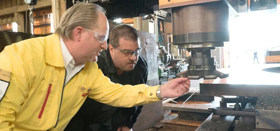

Yet amid all this tradition, the vintage planer mill has assumed pride of place in the Peninsula Iron Works (PIW) shop for making a new kind of history. Converted to CNC in 2004, it has since been retrofitted to operate with a Sandvik Coromant Capto C10 interface. James Johnson, president and co-owner, explains that the shop needed a high-speed, rigid solution for a number of jobs on its evolving task list, which includes work for heavy industry clients in aerospace, hydroelectric, oil and gas, steel mills, mining and aggregate processing.
“I wanted a 3,200-r/min, 24-hour-a-day duty cycle,” Johnson says. “We wanted the Capto C10 on this machine because it has much greater structural integrity than the milling head we had on here before. It’s pretty much run non-stop since we put it on.”
Spindles on machines the size and age of this Cincinnati planer mill typically run at a maximum 1,000 r/min, too slow for smaller-diameter tools to work effectively. The Coromant Capto C10 spindle system runs at a maximum 4,000 r/min. Older machines also lack the ability to deliver coolant through the spindle to the tool tip. This Sandvik Coromant Capto system removes such limitations from a machine of any vintage.
Change is something PIW has always embraced. The new planer milling head is a prototype, and Johnson believes it may spark others. PIW’s in-house Electric Machine Control Systems (EMCS), a subsidiary company that specializes in retrofitting machinery, did the conversion of the machine to CNC and built the all-new Coromant Capto C10 milling head. During the design and manufacturing processes, EMCS worked closely with Sandvik Coromant engineers to produce the milling head and guarantee it would perform to PIW’s expectations.
“Our relationship with Sandvik Coromant is a close partnership, in fact we meet with our local Sandvik Coromant Sales Engineer, Jeff Romine, on a regular basis to discuss the best tools for our applications," says PIW manager Mark Pongracz. “Ninety percent of the tools in this shop are Sandvik Coromant. The Capto system has become the standard interface for all multi-task machine tool builders, and our choice as well, since it performs exceptionally in turning as well as milling.”
EMCS also wanted a platform it could rely on to handle the torque required for jobs such as those involving aerospace titanium milling. Although PIW doesn’t regularly machine titanium, its customers that do so stand to benefit from this spindle technology and milling head. “The pull force you generate with a Capto C10 won’t damage your spindle or your tool, but allows the two pieces to perform as if they were one,” Pongracz explains. “Sandvik provided all the engineering support to EMCS to build PIW the C10 interface into their milling head.”
