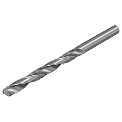

CoroDrill® 452 solid carbide drill
Available within a week
ISO: 452.1-0610-045A0-CM H10F
Material Id: 7516198
EAN: 7323223508188
ANSI: 452.1-0610-045A0-CM H10F
N
O
Cutting diameter
6.1 mm
6.1 mm
Usable length
45 mm
Achievable hole tolerance
(TCHA)
K8
Usable length diameter ratio
(ULDR)
7.377
Orthogonal rake angle
13.46 °
Face effective cutt edge count
(ZEFF)
Cylindrical shank without clamping features (without flange) -metric: 6.10
Connection diameter tolerance
(TCDCON)
h7
H10F
HF
Shank standard group
(BSG)
COROMANT
Chip breaker
CM
Point angle
(SIG)
135 °
Point length
(PL)
1.26 mm
100 mm
98.74 mm
Chip flute length
(LCF)
50 mm
Rotational speed maximum
50,000 1/min
0.031 kg
4/6/18
18.1
