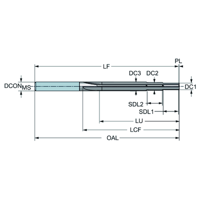

ISO: 452.R-0556-032A0-CM H10F
Material Id: 6010913
EAN: 26010913
ANSI: 452.R-0556-032A0-CM H10F
N
O
Cutting diameter
(DC_1)
3.957 mm
Cutting diameter
(DC_2)
4.744 mm
Cutting diameter
(DC_3)
5.557 mm
Achievable hole tolerance lower
(TCHAL)
5.539 mm
Achievable hole tolerance upper
(TCHAU)
5.567 mm
Premachined hole diameter
(PHD)
3.957 mm
Hole type
(HTY)
through hole
Step diameter length
(SDL_1)
6.02 mm
Usable length
50.8 mm
(SDL_2)
5.95 mm
Step included angle
(STA_1)
Step included angle
(STA_2)
Cylindrical shank without clamping features (without flange) -inch: 7/32
Connection diameter tolerance
(TCDCON)
h8
H10F
HF
Shank standard group
(BSG)
COROMANT
Coolant exit style
5.5563 mm
101.6 mm
88.44 mm
Plug length
(PLGL)
13.16 mm
Cutting edge length
(L)
50.8 mm
Chip flute length
(LCF)
55.88 mm
Flute count
(NOF)
Rotational speed maximum
50,000 1/min
