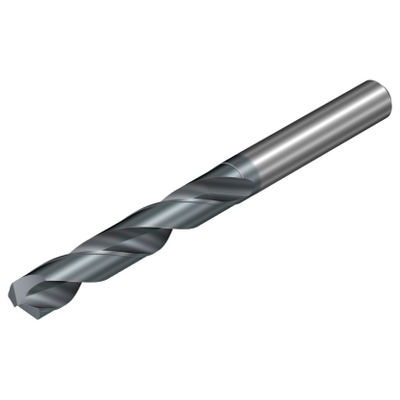

Drill
Solid twist drill
Solid drill with symmetrical point
462.1-1400-042A0-XM X2BM
CoroDrill® Dura 462, solid carbide drill for multi-materials
New
ISO: 462.1-1400-042A0-XM X2BM
Material Id: 8653400
EAN: 7323228356432
ANSI: 462.1-1400-042A0-XM X2BM
N
Cutting diameter
14 mm
14 mm
Usable length
43.6 mm
Achievable hole tolerance
(TCHA)
H9
Usable length diameter ratio
(ULDR)
3.1143
Orthogonal rake angle
20.45 °
Face effective cutt edge count
(ZEFF)
Cylindrical shank (DIN6535-HA) -metric: 14
Connection diameter tolerance
(TCDCON)
h6
X2BM
PVD TiAlCrSiN
Shank standard group
(BSG)
DIN 6537 K
Chip breaker
XM
Coolant pressure
20 bar
Point angle
(SIG)
140 °
Point length
(PL)
2.5478 mm
107 mm
104.962 mm
Chip flute length
(LCF)
60 mm
Rotational speed maximum
9,095 1/min
0.19 kg
1/18/25
25.1
