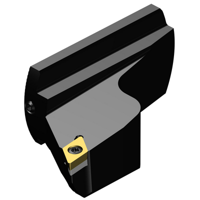

CoroTurn® 107, cutting head for turning
Specific representation
ISO: 570-SDUCL-80-11
Material Id: 5764349
EAN: 12068055
ANSI: 570-SDUCL-80-11
Tool cutting edge angle
93 °
Lead angle
-3 °
Clamping type code
Insert type
DCMT 11T308
SL head (quick change) -size 80

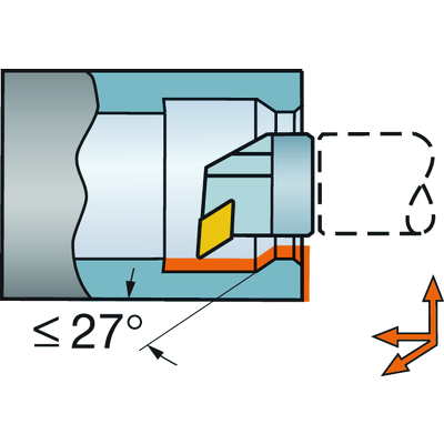

Maximum ramping angle
27 °

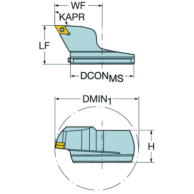

Minimum bore diameter
100 mm
Workpiece side body angle
Machine side body angle
Maximum overhang
45.7 mm
Coolant exit style
80 mm
Shank height
37.5 mm
45.7 mm
Functional width
57 mm
Functional height
