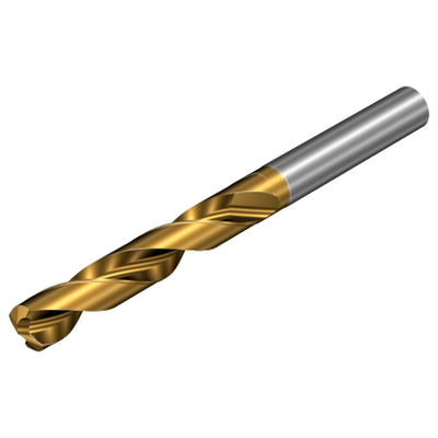

Drill
Solid twist drill
Solid drill with symmetrical point
860.1-1000-031A0-PM P1BM
CoroDrill® 860-PM, solid carbide drill
Available within a week
ISO: 860.1-1000-031A0-PM P1BM
Material Id: 8150984
EAN: 7323226352207
ANSI: 860.1-1000-031A0-PM P1BM

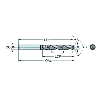

Cutting diameter
10 mm
10 mm
Usable length
31 mm
Achievable hole tolerance
(TCHA)
H8
Usable length diameter ratio
(ULDR)
3.1
Orthogonal rake angle
20.45 °
Face effective cutt edge count
(ZEFF)
Cylindrical shank (DIN6535-HA) -metric: 10
Connection diameter tolerance
(TCDCON)
h6
P1BM
PVD TiAlSiN+TiSiN
Shank standard group
(BSG)
DIN 6537 K
Chip breaker
PM
Point angle
(SIG)
147 °
Point length
(PL)
1.4811 mm
89 mm
87.4 mm
Chip flute length
(LCF)
47 mm
Rotational speed maximum
7,958 1/min
0.0757 kg
