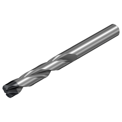

Drill
Solid twist drill
Solid drill with symmetrical point
860.1-1000-081A1-SD S2BM
CoroDrill® 860-SD, solid carbide drill for ISO-S
Available within a week
ISO: 860.1-1000-081A1-SD S2BM

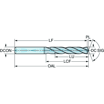

Cutting diameter
10 mm
10 mm
Usable length
81.82 mm
Achievable hole tolerance
(TCHA)
H9
Usable length diameter ratio
(ULDR)
8.182
Orthogonal rake angle
20.45 °
Face effective cutt edge count
(ZEFF)
Cylindrical shank (DIN6535-HA) -metric: 10
Connection diameter tolerance
(TCDCON)
h6
S2BM
PVD TiAlSiN
Shank standard group
(BSG)
COROMANT
Chip breaker
SD
Point angle
(SIG)
140 °
Point length
(PL)
1.8199 mm
152 mm
150.18 mm
Chip flute length
(LCF)
106 mm
Rotational speed maximum
1,083 1/min
0.13 kg
