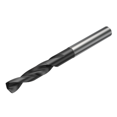

Drill
Solid twist drill
Solid drill with symmetrical point
863.1-0635-026A0-O N20C
CoroDrill® 863, solid carbide drill
Out of stock
ISO: 863.1-0635-026A0-O N20C
Material Id: 7096114
EAN: 7323221259754
ANSI: 863.1-0635-026A0-O N20C
O

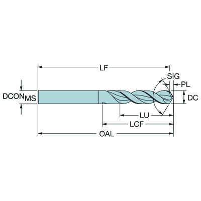

Cutting diameter
6.354 mm
6 mm
Usable length
26 mm
Achievable hole tolerance
(TCHA)
H8
Achievable hole tolerance lower
(TCHAL)
6.354 mm
Achievable hole tolerance upper
(TCHAU)
6.376 mm
Usable length diameter ratio
(ULDR)
4.0919
Orthogonal rake angle
16.22 °
Face effective cutt edge count
(ZEFF)
Cylindrical shank (DIN6535-HA) -metric: 6
Connection diameter tolerance
(TCDCON)
h6
N20C
CVD Sp3
Shank standard group
(BSG)
COROMANT
Chip breaker
O
Point angle
(SIG)
118 °
Point length
(PL)
1.84 mm
75 mm
73.16 mm
Chip flute length
(LCF)
37 mm
Rotational speed maximum
20,000 1/min
