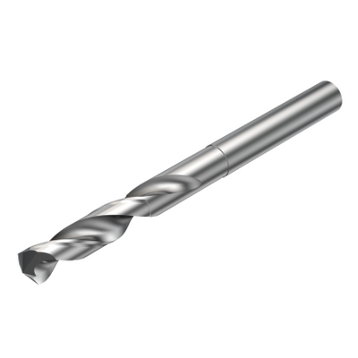

Drill
Solid twist drill
Solid drill with symmetrical point
863.1-1112-043A1-OS H10F
CoroDrill® 863, solid carbide drill
Available within a week
ISO: 863.1-1112-043A1-OS H10F
Material Id: 6882087
EAN: 7323220338672
ANSI: 863.1-1112-043A1-OS H10F
O
Cutting diameter
11.122 mm
12 mm
Usable length
43 mm
Achievable hole tolerance
(TCHA)
H8
Achievable hole tolerance lower
(TCHAL)
11.122 mm
Achievable hole tolerance upper
(TCHAU)
11.144 mm
Usable length diameter ratio
(ULDR)
3.8662
Orthogonal rake angle
16.22 °
Face effective cutt edge count
(ZEFF)
Cylindrical shank (DIN6535-HA) -metric: 12
Connection diameter tolerance
(TCDCON)
h6
H10F
HF
Shank standard group
(BSG)
COROMANT
Chip breaker
OS
Coolant pressure
9 bar
Point angle
(SIG)
135 °
Point length
(PL)
4.62 mm
105 mm
100.38 mm
Chip flute length
(LCF)
58 mm
Rotational speed maximum
1,200 1/min
0.12 kg
9/23/15
15.2
