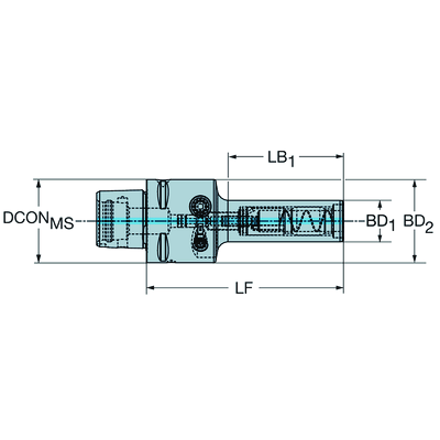

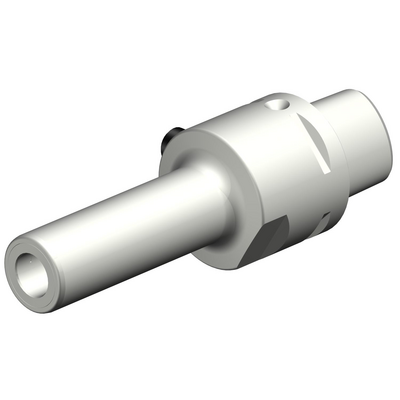

Specific representation
ISO: 930-C4-P-12-100
Material Id: 6255472
EAN: 26255472
ANSI: 930-C4-P-12-100
Connection - workpiece side
(ADINTWS)
Hydraulic Membrane chuck -metric: 12
Coolant exit style
axial concentric exit
Coolant pressure
80 bar
40 mm
Functional diameter
(DFC)
28 mm
Standard number
(STDNO)
ISO26623-1
Connection diameter workpiece side
(DCONWS)
12 mm
Kappa (z-axis rot)
(KAP)
100 mm
Body diameter
(BD_1)
22 mm
Body diameter
(BD_2)
40 mm
Body length
(LB_1)
60.8 mm
Body length
(LB_2)
100 mm
Body half taper angle
(BHTA_1)
(BHTA_2)
8 Nm
Rotational speed maximum
39,000 1/min
Body material
Steel
Balancing method code
(BLMC)
Balancing by design
0.508 kg
124 mm
2/20/13
13.1
