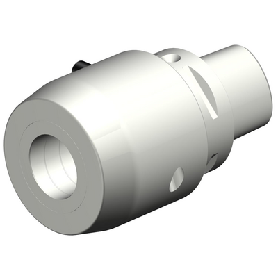

Coromant Capto® to CoroChuck® 930
Specific representation
ISO: 930-C6-HD-32-091
Material Id: 6255455
EAN: 26255455
ANSI: 930-C6-HD-32-091
Connection - workpiece side
(ADINTWS)
Hydraulic Membrane chuck -metric: 32 (excluding WE/WN shanks)
Coolant exit style
axial concentric exit
Coolant pressure
1,160.3019 lbf/in2
2.4803 inch
Functional diameter
(DFC)
1.7323 inch
Standard number
(STDNO)
ISO26623-1
Connection diameter workpiece side
(DCONWS)
1.2598 inch
Kappa (z-axis rot)
(KAP)
3.5827 inch
Body diameter
(BD_1)
2.6772 inch
Body diameter
(BD_2)
2.9921 inch
Body length
(LB_1)
0.7402 inch
Body length
(LB_2)
3.5827 inch
Body half taper angle
(BHTA_1)
12 °
(BHTA_2)
7.3756 ftlbf
Rotational speed maximum
20,000 1/min
Body material
Steel
Balancing method code
(BLMC)
Balancing by design
5.796 lb
5.0787 inch
