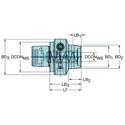

Coromant Capto® to CoroChuck® 930
Specific representation
ISO: 930-C4-T-12-042
Material Id: 6976412
EAN: 7323220795390
ANSI: 930-C4-T-12-042
Coromant Capto (segment clamping only) -size C4
Connection - workpiece side
(ADINTWS)
Hydraulic Membrane chuck -metric: 12
Coolant exit style
axial concentric exit
Coolant pressure
80 bar
40 mm
Functional diameter
(DFC)
28 mm
Standard number
(STDNO)
ISO26623-1
Connection diameter workpiece side
(DCONWS)
12 mm
Kappa (z-axis rot)
(KAP)
42 mm
Body diameter
(BD_1)
28 mm
Body diameter
(BD_2)
32 mm
Body diameter
(BD_3)
48 mm
Body length
(LB_1)
11.3 mm
Body length
(LB_2)
17 mm
Body length
(LB_3)
42 mm
Body half taper angle
(BHTA_1)
10 °
(BHTA_2)
(BHTA_3)
8 Nm
Rotational speed maximum
10,000 1/min
Body material
Steel
Balancing method code
(BLMC)
Balancing by design
0.417 kg
66 mm
2/16/16
16.1
